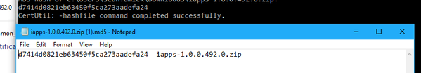

have you tried reimporting the iApp, perhaps even redownloading the package and double checking the MD5.
- SeanPAmick_3357
I tried reimporting and re-downloading, hash image:
I tried to de-provision AVR, still spits out the same error.
-Sean
