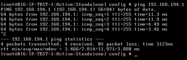

I can ping the gateway as well as the other IPs in NAT network, but for the IPs from other network is unreachable (like 192.168.3.1 and 8.8.8.8)
Using Wireshark I can see that my ping packets can reach its destination but there are no response coming back.

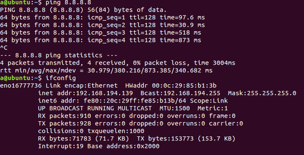

Trying with other VMs on the same VM NAT network, I can see that there are no problem for them to connect to other networks. Below is my Ubuntu VM on NAT network pinging other networks and addresses on the internet I think VMWare is not the main problem here, also I have not set any packet filter rules on BIG-IP yet, anyone got any ideas about the problem I am facing? Thanks in advance.

  • NAT Gateway is .2 and not .1
    Change the GW address to .2 and it will start working.

      Thank you a lot, I spent 3 days trying to fix this problem not knowing about the NAT gateway.
