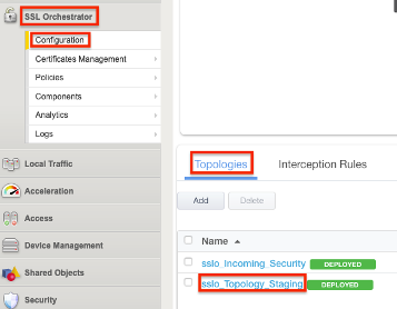

From the SSL Orchestrator Configuration Utility click SSL Orchestrator > Configuration > Topologies > sslo_Topology_Staging.

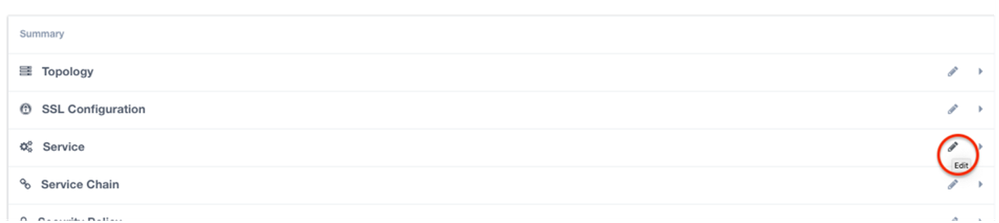

Click the pencil icon

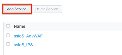

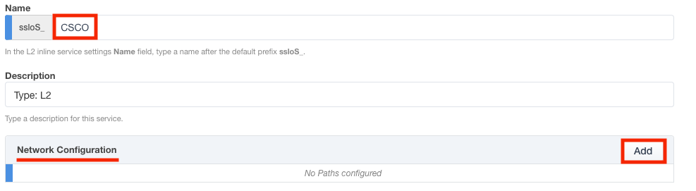

Click Add Service
Double click Cisco Firepower Threat Defense Inline Layer 2
Give it a name or leave the default. Click Add

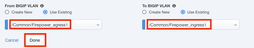

Set the FROM and TO VLANS to the following, click Done

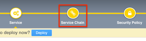

Click Service Chain

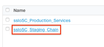

Click the Staging_Chain

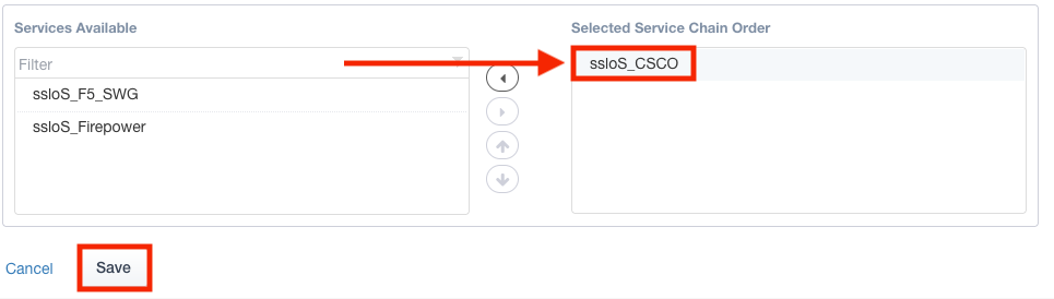

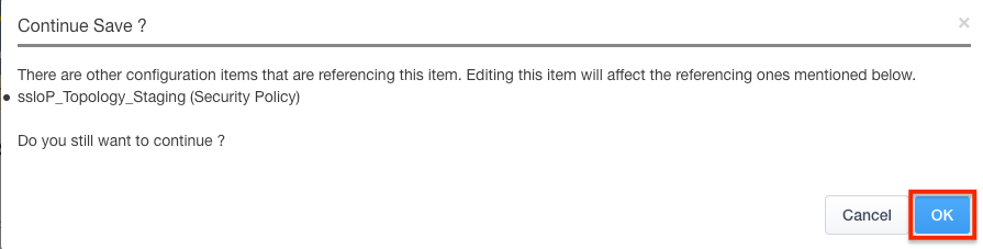

Move the CSCO Service from Available to Selected, click Save
Click OK

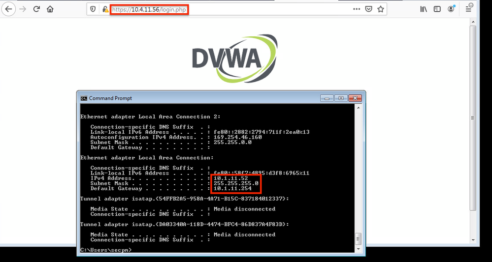

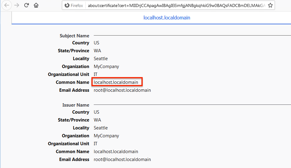

We created a policy with source IP = 10.1.11.52 to use the new Firepower Service that we just performed maintenance on. Go to that computer and verify that everything is still working as expected. As you can see this is the test client with IP 10.1.11.52. The page still loads for one of the web servers
You can view the Certificate to see that it is not the same as the Production Certificate

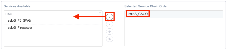

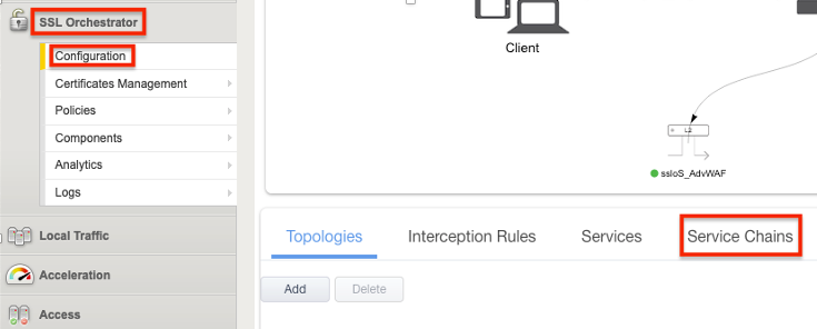

From the SSL Orchestrator GUI select Service Chains
Select the Staging_Chain
Select ssloS_CSCO and click the left arrow to remove it from Selected

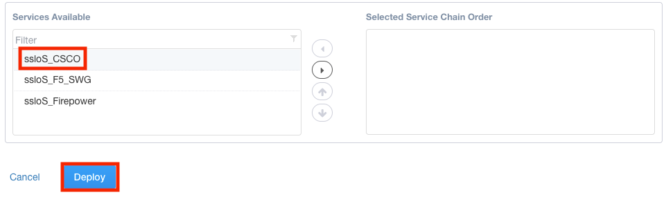

Click Deploy
Click OK
Click OK

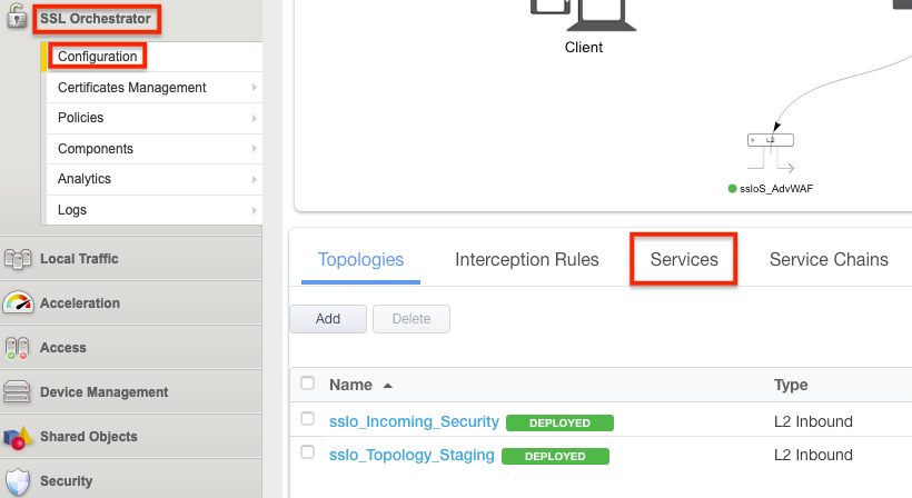

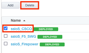

From the SSL Orchestrator Guided Configuration select Services

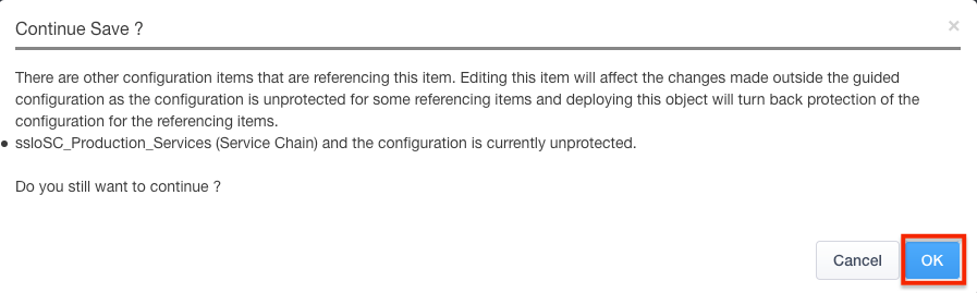

Select the CSCO Service, click Delete
Click OK

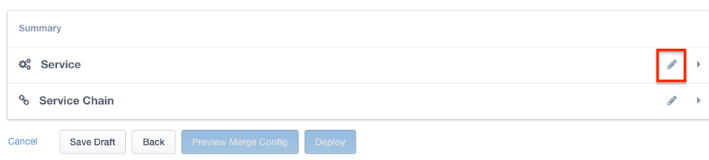

Click the ssloS_Firepower Service
Click the Pencil icon

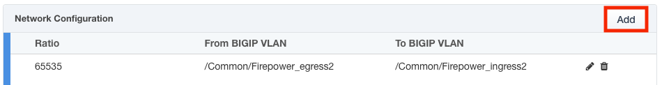

Click Add
Set the Ratio to 65535. Set the From and To VLAN the following, click Done.

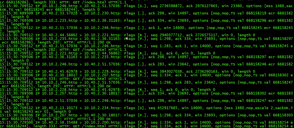

Make sure Firepower1 is working properly by viewing the Statistics
This Firepower device is actively processing connections.
