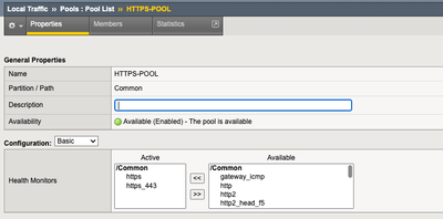

I created a pool with two nodes ( both pointing to the same server one via Ip the other via FQDN both for HTTPS)
I added the Pool to the virtual server and add my irule to the virtual server.
