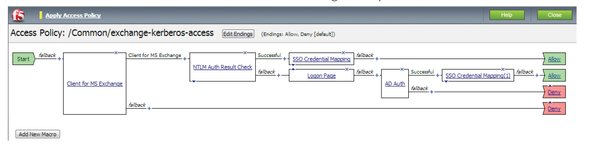

Right now the policy is setup with logon page -> LDAP Authentication -> SSO credential mapping - Allow
Pretty standard. The question is, could I insert upfront logon page NTLM check based on URI ?
Something like this :
and iRule , if needed :

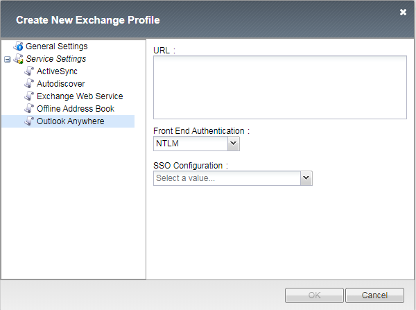

  • Hello Kaloyan,
    Did you use an Exchange profile?
    Because you can easly set frontend Authentification and SSO by URL/Service:
    Regards

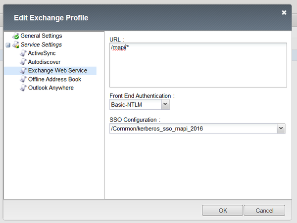

      Hi youssef,
      yes, I have exchange profile.
      Can I borrow one of the predefined Service Settings and add /mapi* instead of /ews* for example ?
      And probably will need to add SSO Configuration with Kerberos for NTLM ?
      Should I change the policy as well with some NTLM checks ?
      Do I need this ECA enabled on the VIP ?
      So many questions :)
