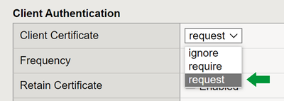

We have to expect that the client might come without the TLS certificate when accessing non-sensitive URL. To accomodate this condition, we have to adjust the Client-SSL profile attached to the VS to allow clients without client SSL certificate. We can select the "request" option on Client Certificate of the Client Authentication section inside the Client SSL profile.
