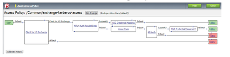

Jun 12, 2020APM VIP with exchange servers and NTLM authentication
I used the exchange 2016 iApp ( latest version) to setup one VIP with all services behind it. The problem is that /mapi* should be with NTLM authentication, but rest of it like /owa is using basic a...

Jun 12, 2020Hello Kaloyan,
Did you use an Exchange profile?
Because you can easly set frontend Authentification and SSO by URL/Service:

Hi youssef,
yes, I have exchange profile.
Can I borrow one of the predefined Service Settings and add /mapi* instead of /ews* for example ?
And probably will need to add SSO Configuration with Kerberos for NTLM ?
Should I change the policy as well with some NTLM checks ?
Do I need this ECA enabled on the VIP ?
So many questions :)
