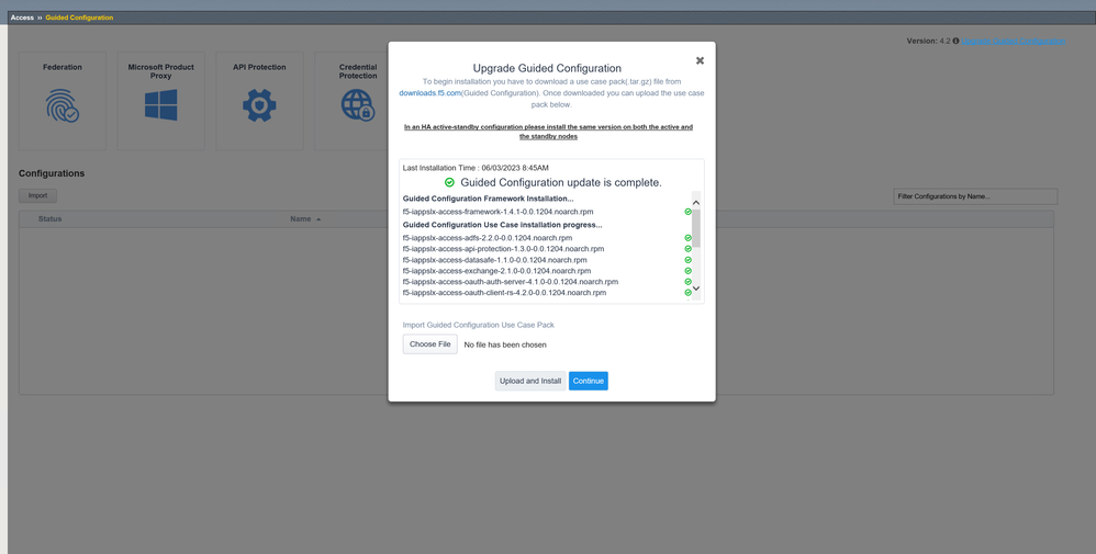

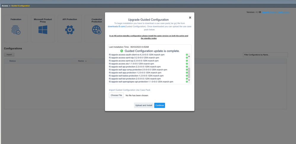

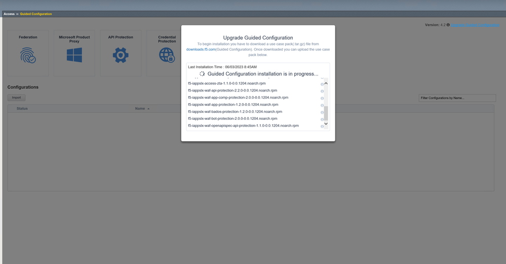

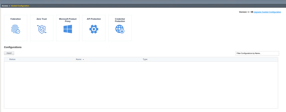

  • HI southern_shredd ,,
    I just tried running the Guided configuration in APM Access section after chagning the partion from Common to other partition and geting this error as you told:
    I chnage the partition back to Common from the drop down list and can see its the only way:
    As per best of my understanding guided policy can be create din the present version only in the /Common partition but i assume they can be applied to a VIP in another partition, as i can undertand you dont want to give the policy restrictions to be visible to other partition admins a s it ill be visible if oyu create the guided policy in common will be accessible to all the admins.
