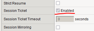

I am currently in the process of migrating our F5 config towards AS3. However, I am currently running into an issue while converting the 'Session Ticket' attribute of our clientssl profiles (TLS_Server in AS3) While the AS3 Schema reference allows to provide a sessionTickets attribute for TLS_CLIENT objects, there is no such option for TLS_Server objects that I am able to find. Does anybody know how to set this attribute for SERVER_TLS objects in AS3? Is it just not possible? Is there a different option I need to use with AS3? Thanks in advance67Views0likes0CommentsUpdating all references to a particular object in F5 config
