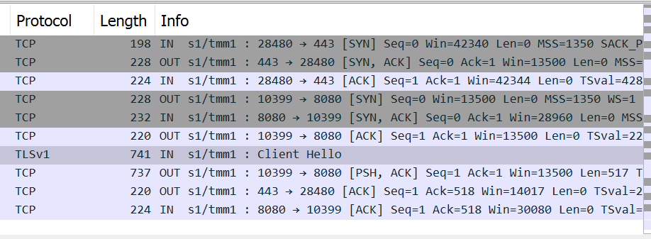

i have an issue, where i have F5 LTM VS (Standard - SSL Passthrough (no client/server SSL profile).
Issue - URL is not accessible, getting error message site can't be reach.
Bypassing LB it works properly. I took packet capture and observed that TCP Hnadshake is happeing but SSL handshake is not happening. Client hello is coming but Server hello is not happenning and no error message in packet capture.
Please let me know if issue is with F5 or not.

@Paulius ==> updated packet capture screenshot. Connectivity is in place. TCP handshake is happening. But SSL Handshake is not happening. Regarding that tcp timeout, its all default value, only idle timeout is set as 600 seconds.
