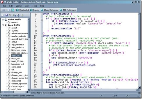

First, log into your existing LTM system with your iRule editor (you are using the editor, right? Of course you are…just making sure).  You’ll see a screen something like this (right) with a list of a bagillionty iRules on the left and their cool, color coded awesomeness on the right.  You can go through and select iRules and start moving them manually, but there’s really no need.
All you need to do is go up to the File –> Archive –> Export option and let it do its magic.  All it’s doing is saving text files to your local system to archive off all of your iRuley goodness.  Once that’s done, you can then spin up your new LTM VE and get logged in via the iRule editor over there.  Connect via the iRule editor, and go to File –> Archive –> Import, shown below.

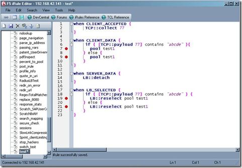

Once you choose the import option you’ll start seeing your iRules popping up in the left-hand column, just like you’re used to.  This will take a minute depending on how many iRules you have archived (okay, so I may have more than a few iRules in my collection…) but it’s generally pretty snappy.  One important thing to note at his point, however, is that all of your iRules are bolded with an asterisk next to them. This means they are not saved in their current state on the LTM.  If you exit at this point, you’ll still be iRuleless, and no one wants that. Luckily Joe thought of that when building the iRule editor, so all you need to do is select File –> Save All, and you’ll be most of the way home.
I say most of the way because there will undoubtedly be some errors that you’ll need to clean up. These will be config based errors, like pools that used to exist on your old system and don’t now, etc.  You can either go create the pools in the config or comment out those lines. I tend to try and keep my iRules as config agnostic as possible while testing things, so there aren’t a ton of these but some of them always crop up.  The editor makes these easy to spot and fix though. The name of the iRule that’s having a problem will stay bolded and any errors in that particular code will be called out (assuming you have that feature turned on) so you can pretty quickly spot them and fix them.
