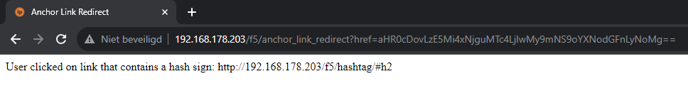

    Yes, you're completely right, these links that contain a hash sign are not being forwarded from the browser to the server. But the solution below might help you out. The iRule below needs to be attached to a virtual server with the STREAM-profile enabled. It wil inject a little bit of javascript that inspects all links that are being clicked. When the link contains a hash sign, it will redirect the browser back to the F5.
    when HTTP_REQUEST {
        # Disable the stream filter by default
        STREAM::disable
        # LTM does not uncompress response content, so if the server has compression enabled
        # and it cannot be disabled on the server, we can prevent the server from
        # sending a compressed response by removing the compression offerings from the client
        HTTP::header remove "Accept-Encoding"
        if { [HTTP::uri] starts_with "/f5/anchor_link_redirect" } {
            set href [b64decode [URI::query [HTTP::uri] href]]
            HTTP::respond 200 content "<html><head><title>Anchor Link Redirect</title></head><body>User clicked on link that contains a hash sign: $href</body></html>"
    when HTTP_RESPONSE {
        if { ([HTTP::header "Content-Type"] starts_with "text/html") } {
            STREAM::expression {@</title>@</title>
        <script>
        document.addEventListener(`click`, e => {
          const origin = e.target.closest(`a`);
          if (origin && origin.href.indexOf('#') > -1) {
            const base64_href = btoa(origin.href);
            window.location.href = '/f5/anchor_link_redirect?href=' + base64_href;
        </script>@}
            STREAM::enable
    The iRule will show the following output, when a link with a hashtag is clicked.
    Have fun,
         --Niels
