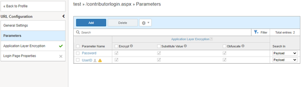

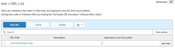

      ###################URL########################
      ########### PARAMETERS #################################

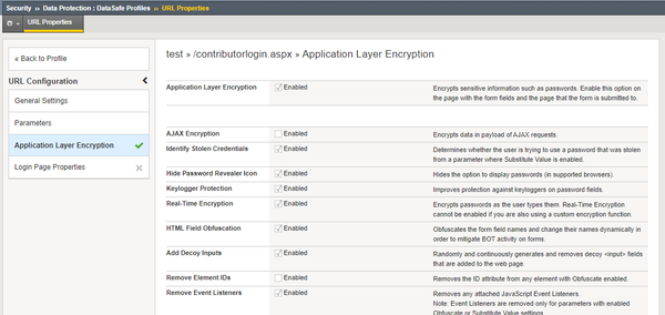

      ############APPLICATION LAYER ENCRYPTION ##########

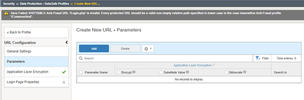

      Erik I am getting error of lower case sensitive as my URL is in upper case letter....any solution for this ?
  • Yes. By default, DataSafe treats URLs in the URL list as case-sensitive. There is a checkbox for the option in the properties of the URL. By default, the option is not selected, and you should only select it if your app uses case-sensitive URLs. The problem is that you cannot change the settings after the anti-fraud profile is created. So to fix this problem, delete the profile and create a new one. Most likely your app is not case sensitive.
