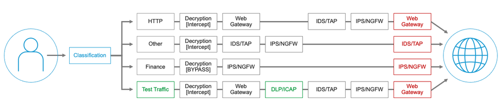

      In general, the SSLO will decrypt and forward traffic based on your security policy in combination with any dynamic service chain (see pictures below).
      With the security policy you define your criterias for a specific traffic type (i.e. URLs) and the action (allow, drop etc.). You can also configure if this traffic type should be decrypted or not and to which service chain it should be forwarded.
      • Bypass means no TLS/SSL decryption
      • if a service chain is selected, SSLO will forward the traffic to all devices in this chain
      You can configure different chains to involve different inspection devices in different order etc.

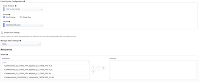

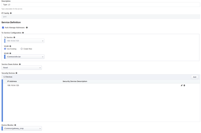

        I have configured the NGFW as a L3 service using the provided IP addresses (even through I cannot understand why I cannot use other private IP addresses).
        The L3 service can be viewed below:

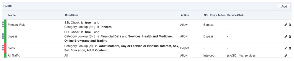

        The configured security policy is the below:

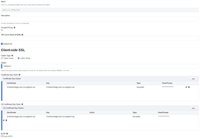

        The SSL configuration is the below:
