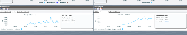

Hello All,
We've been performing load testing for an application that is going to be deployed in the near future and during that load testing I noticed that our 8950 LTM going over the base license 500 tps for SSL, typically it would drop back down below the threshold pretty quickly never remaining above 500 for more than a second or so. After reviewing SOL6475: Overview of SSL TPS licensing limits it sounds like it might be best to upgrade the SSL license so that SSL connections aren't dropped? Just wanted to get other members experience with this.
Thanks,
Brian
