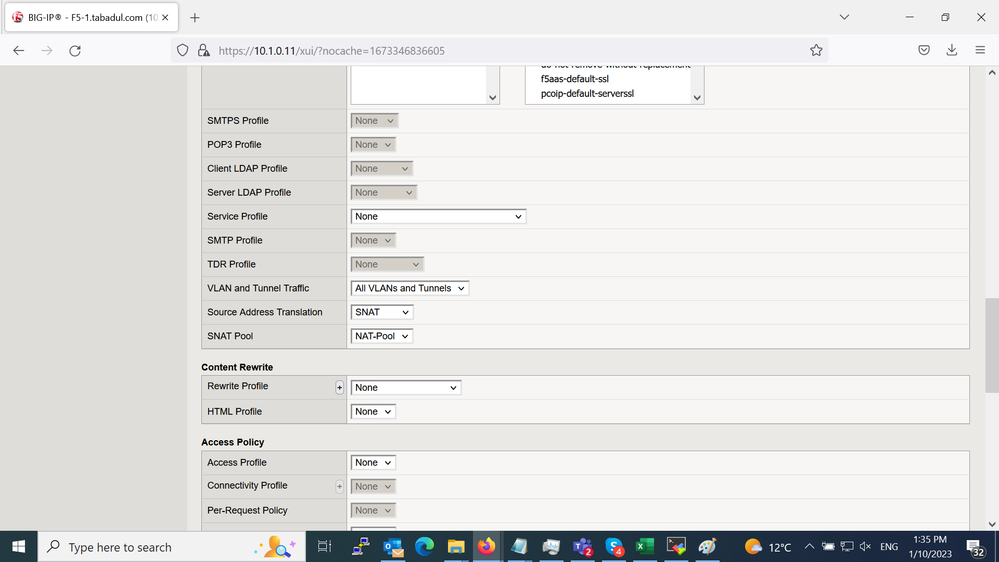

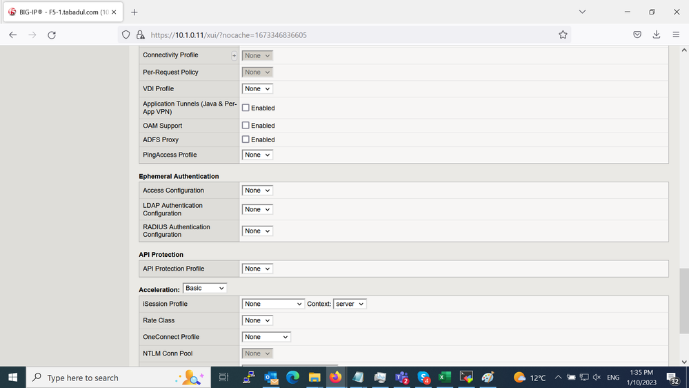

we Have F5 device working in HA mode , we create a virtual server for a server as below
the server working with port 8189
the Virtual server created with port 443
SSL offloading is enabled
when the users try to login to the server the login panel is appered and the user try to enter username and password but the page back to login page without no action while when we change the port to 9898 or any other port it's working fine without any issue could anyone help us with that ?

Can you please share the config of the vip , irule etc?
hello dear
it's only one server the role of the F5 device is acting as reverse proxy
Bests

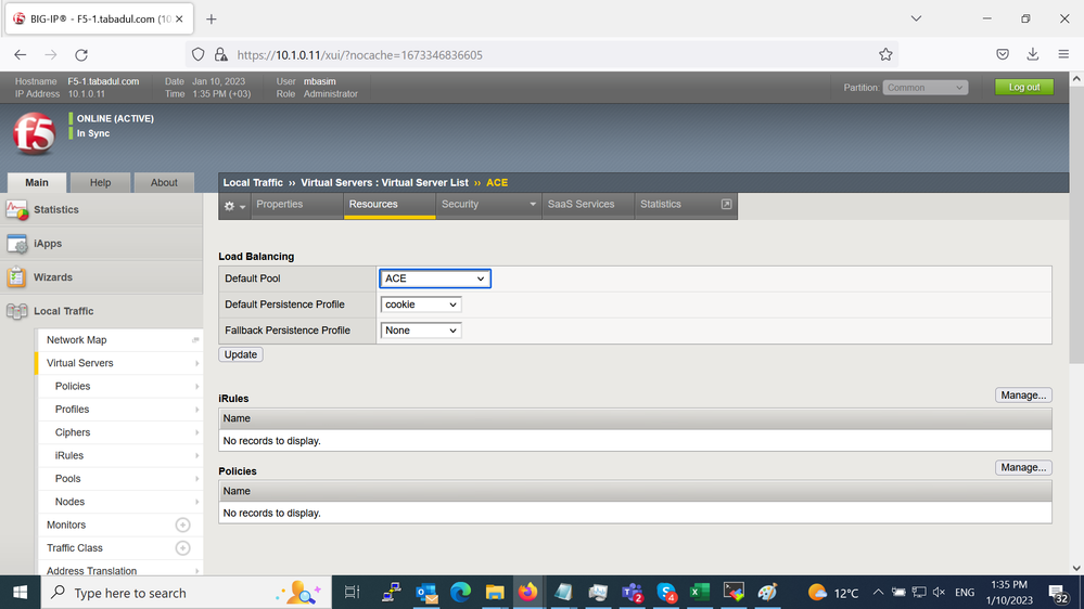

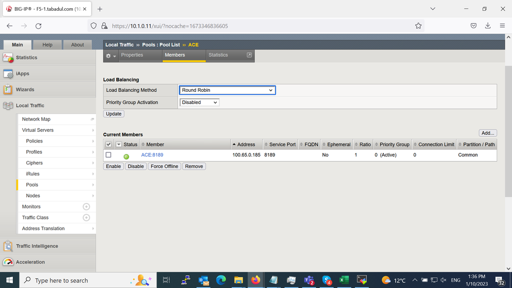

Hi MustphaBassim,
Browsers tipically open multiple TCP sessions to a server when transferring data, so it might happen that some of those sessions go to a server and some to another. When you consider authentication, the server you authenticated to allows you to see the content, but the other does not. That might be why you're getting redirected to the login page.
So I would suggest having a persistence profile in place (maybe based on source address, maybe cookie). Want to try that?
[Edit: the pool has 1 member, so forget the idea 😞 ]

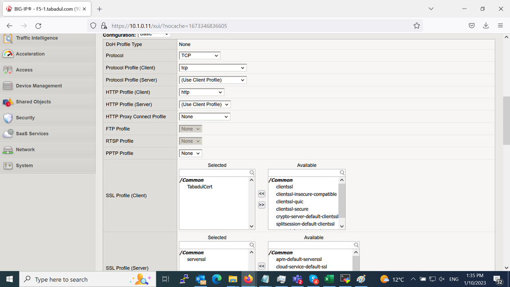

Hi Mustpha,
You can take a concurrent packet capture from both the client and server side to confirm what is really going on.
You can decrypt the traffic as described in this article here:
https://community.f5.com/t5/technical-articles/decrypting-tls-traffic-on-big-ip/ta-p/280936
