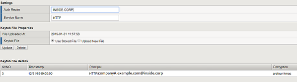

The keytab file is uploaded under Access->AAA->kerberos & auth realm INSIDE.CORP is used.

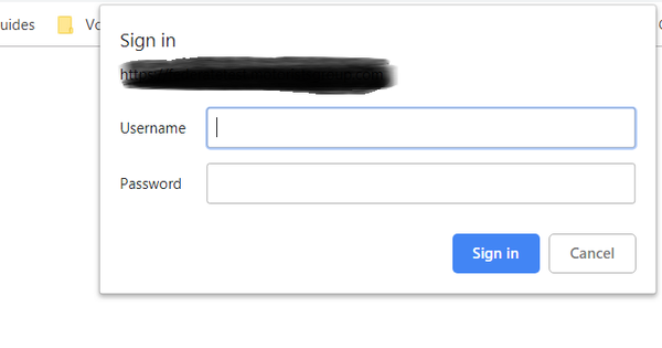

From Client side, SSO doesn't work and getting a browser pop-up where i can input the credentials. Entering the creds doesn't work either.

  • Are you able to share a screenshot of the AAA->kerberos configuration?

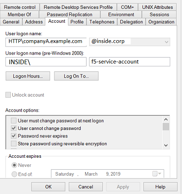

    Here's some more details on the service account:
