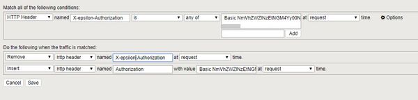

I try it with Policy:
Condition
"HTTP HEADER" named "X-epsilon-Authorization" "is" "any of" "Basic XXXX" at "request"
Action
"Remove" "http header" named "X-epsilon-Authorization" at "request"
"Insert" "http header" named "Authorization" with value "Basic XXX" at "request"
