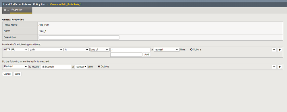

    > For LTM Policy you Can do like this , it works with me and successfully authenticated as well :
    Test both workarounds , hope it help
