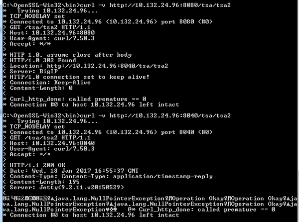

1.Check to see if there are any errors in the logs.
2.Can you run a curl command to see what kind of redirect or response you are getting ? This will help identify the issue.
- Vijay_E
Cirrus
Based on the CURL output (Location Header), the redirect seems to be working.
