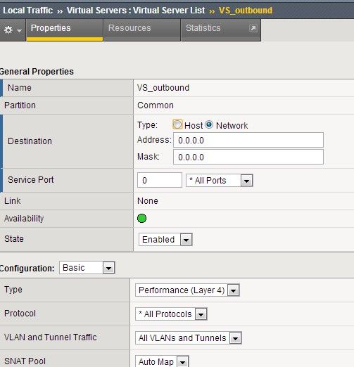

  • Thanks Aaron!I tried your suggestion,modified my irules and I found nothing in gtm log.Instead I found something in /var/log/ltm.Would these be helpful?
    [link text](https://devcentral.f5.com/Portals/0/Users/214/34/133334/my test irule.jpg)
    [link text](https://devcentral.f5.com/Portals/0/Users/214/34/133334/ltm log.jpg)

    I´m wondering, if you are trying to apply address translation to the traffic to forward.
    At least your virtual server is in PerformanceL4 mode. And probably you have a pool assigned, dont you? Is it a default_gateway_pool?
    If there is no pool, you cannot expect the LB_SELECTED event to be triggered and nothing will show up in /var/log/ltm.
    Did you change the NAT and Port translation settings in your virtual server properties?

  • According to the current VS configuration you still have SNAT AutoMap enabled.
    Perhaps this overrules the iRule ...
    tmsh modify ltm virtual VS_outbound snat none
    tmsh save sys config
    tmsh run cm config-sync to-group device-group-failover
    Command above removes the SNAT from your virtual server and the iRule should work as expected.
