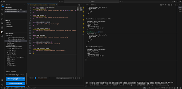

Now we need some client and server payload. Thankfully we have that covered with the script I shared in part one. We just need to unleash it! I have my Visual Studio Code IDE fired up with the F5 Extension and iRules editor marketplace extensions connected to my v21 BIG-IP, I have the iRule above loaded up in the center pane, and then I have the terminal on the right pane split three ways so I can a) generate traffic in the top terminal, b) view the server request/response in the middle terminal, and c) watch the logs from BIG-IP in the bottom terminal. Handy to have all that in one view in the IDE while working.
For the first pass, I'll send a request expected to work through the BIG-IP and get a response back from my test server. That command is:
./cspayload.py client --host 10.0.2.50 --port 80
And the result can be seen in the picture below (shown here to show the VS Code setup, I'll just show text going forward.)
You can see that the request triggered HTTP_REQUEST, JSON_REQUEST, and JSON_RESPONSE as expected.
