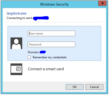

The authentication has a issue when you do a SP initated SAML request from the intranet website to saml.demo.com. The 401 reponse does it jobs and creates a session on the Bigip. But after this has been completed the users gets a NTLM basic popup for credentials. If you enter the correct credentials in this box nothing happens afterwhorths. If you close the pop-up box, and without closing the browser go back to the intranet website and do a SP initiated SAML request again the previous established session gets used and the user gets redirected back to the intranet website with a SAML assertion and is logged in correctly. If you close the browser and open it again you can repeat the process.
We are testing this with IE11 with the saml and intranet website added to intranet zone and auth.
Logging shows a full completion of the APM policy and no errors are new 401 requests.
The IE11 pop-up

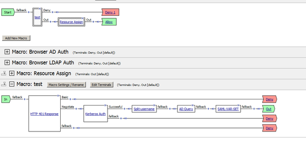

The APM policy looks as follows:
Running version 12.1.2 HF1
