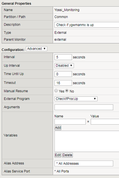

We are trying to monitor specific process on remote server, if it run's then application is up if not then it is down. For that we developed small script (Shown below). The point is that when we run the script from F5 GUI it look like it does not doing what it should do. When running the commands form command line all seem to be OK.
Thanks in advance for the help on this topic.

Here what we are getting from test: LTM::Monitor /Common/Yossi_MonitoringMonitor Test Result: Destination: 10.0.10.2:5588 Last state: down State time: 2018.05.08 12:33:44 (0hr:0min:6sec ago) Last result: Test Completed (DOWN) No successful responses received before deadline. See /var/log/monitors/Common_Yossi_Monitoring-Common_monitor_test-5588.log

I can see you probably forgot to set param to that ssh non-default port (-p $2).
Anyway, what about to try this way:
!/bin/sh pidfile="/var/run/`basename ${0}`.$1..$2.pid" if [ -f $pidfile ] then kill -9 -`cat $pidfile` > /dev/null 2>&1 fi echo "$$" > $pidfile Remove the IPv6/IPv4 compatibility prefix ip=`echo $1 | sed 's/::ffff://'` port=$2 ssh -p $port root@$ip "ps -ef |grep ygwmanmx |grep -v grep 2>&1 > /dev/null" status=$? if [ $status -eq 0 ] then rm -f $pidfile echo "up" fiTest:
&1 > /dev/null' + status=0 + '[' 0 -eq 0 ']' + rm -f /var/run/monitor.sh.192.168.74.6..5588.pid + echo up upBest Regards.
