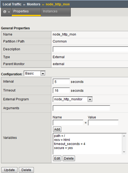

1) Import into BigIP as an external monitor file under: System ››File Management >>External Monitor Program File List.
2) Create an external monitor using name entered in step 1. Under Local Traffic ›› Monitors
3) Add variables to monitor as follows, order is not important:
  • path: This is the path and page name which you use for testing. e.g. /myapp/default.aspx, or /, or /owa
  • recv: This is the receive string which will indicate proper operation.
  • timeout_seconds: This is the request time out after which node will stop waiting for a response.
  • secure: Any value for this variable will indicate that you want to use HTTPS. Omit this if you want HTTP.
4) Assign monitor to a pool
