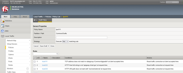

  • because the "else" is basicaly reject, you can just simply assing the pool to the virtual server and bind below traffic policy to the virtual server.
    it is better to use local traffic policy instead of irules scripting due to better performance and avoid scripting typo.

      Thanks, zamroni. I realized I needed to add some additional lines, per F5s recommendation for software releases after v14. This is per https://my.f5.com/manage/s/article/K23237429.
      I like your suggestion about the local traffic policy. I will try that next time I get these requests.
