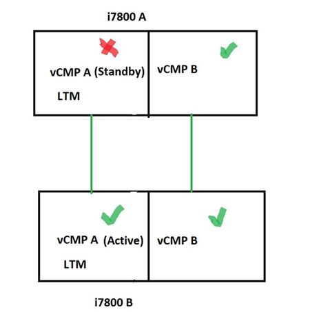

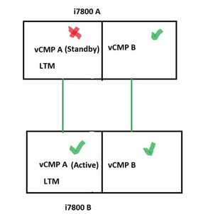

Oct 08, 2020Management connection to Standby vCMP guest on i7800 chassis is extremely slow
At first glance, a simple problem arose - a very slow connection to the F5 management interface, it barely connect users to Web GUI, ssh, iControl Rest API. I noticed the messages in the logs: serv...

May 17, 2021I haven't found any smart solution but you can redeploy the vCMP guest to solve this problem.
