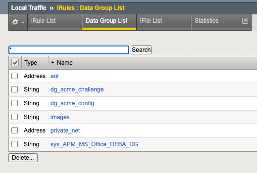

The script adds a few new shiny toys to your BIG-IP. You will find two new data groups and a new iRule.
The data group dg_acme_config houses the subject and CA or your certificate. We will need to modify this data group before we run the script; more on this in a moment. The dg_acme_challenge holds the challenge tokens and is ephemeral, cleaning up when the process completes.

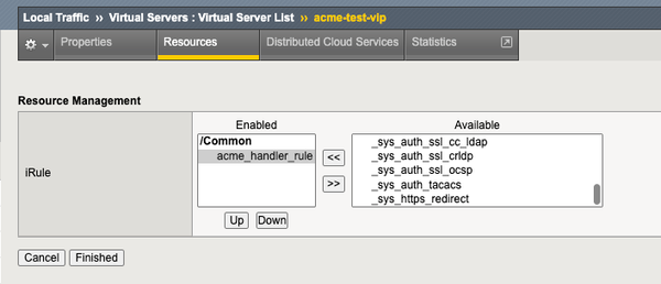

The iRule handles the HTTP-01 challenge. You need this iRule applied to the port 80 VIP when you run the script. At a high level, the iRule intercepts the challenge request from the ACME server and responds with an appropriate challenge response. In scenarios without a proxy, such as the BIG-IP, the web server handles this. Alternatively, you can use a DNS challenge by adding a TXT record at your registrar. The HTTP method is much simpler, so that’s what we will use here.
Step 2: Configure Your Virtual IP
Create an HTTP Virtual IP (VIP) to handle the ACME challenges. Production environments usually need both HTTP (port 80) and HTTPS (port 443) VIPs. Our demonstration uses a simple HTTP-only setup.
Critical requirement: The ACME iRule must be applied to your port 80 VIP to enable HTTP-01 challenge processing.

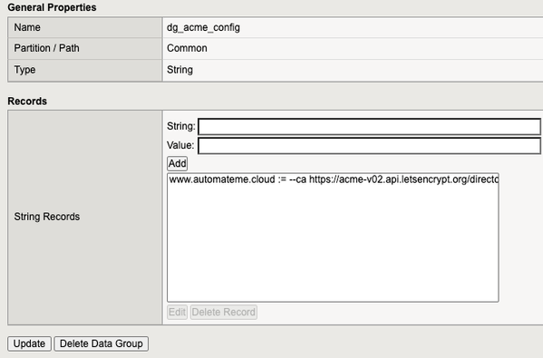

Step 3: Configure the Data Group - dg_acme_config
We need to add our domain and CA information at a minimum.
Add your domain to the string field and your CA information to the value field. See the documentation for more examples.

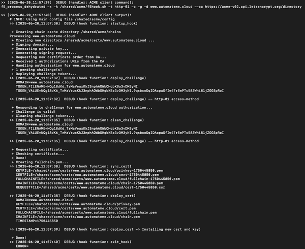

Step 5: Run the script
Ok, you have DNS configured, VIP configured, and the data group modified with your domain and CA information. You are ready to roll. Go to the directory and run the script.
cd /shared/acme
./f5acmehandler.sh -verbose
The verbose flag provides real-time feedback on the ACME communication process, invaluable for troubleshooting and understanding the workflow.
Success?
If you are successful, you should see output similar to the screenshot below.  If not, then the details of the script workflow should clue you into the problem. The GitHub repo also offers some troubleshooting advice.

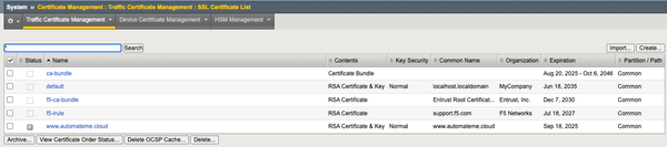

Also, let's see if we got a brand new shiny certificate. Yep.
