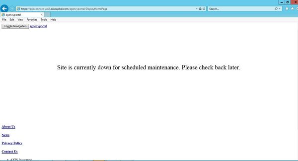

  • Hi Gersbah ,
    We have updated all the Maintenance related files in single folder after that Maintenance page displaying.
    But when we first time accessing https://axisconnect-uat2.axiscapital.com/agencyportal/DisplayHomePage it is displaying maintenance page same when we are refreshing that page in browser it is displaying the 404 error page .
    Can you please help me on this
