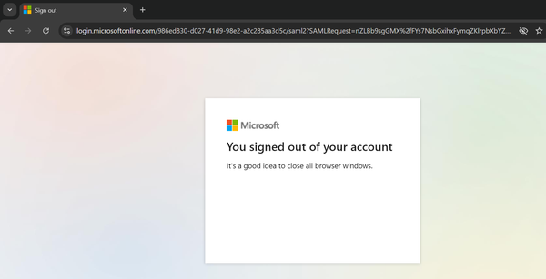

Login authentication error on F5 apm
Hi Team,
We have setup SAML authentication for our onprem application with AZUR AD on F5 APM.  In first place saml authentication working and after that it make query to On prem AD sever. after that we are getting below error message.
Please help us me to resolve this issue.

      Thanks for updating ..please find the below details.
      • Is this impacting all users, or just some? Azure does this if people are signing into multiple accounts, requiring that the users clear their browser history --No its new requirement
      •              Users are first authenticating through SAML and after that it will make query to on prem AD server and login page will open.  SAML authentication working after that AD deny traffic.
      • Azure cert no expired.  First time we are setuping this authentication with SAML
      is there any setting require on AD side for kerbose authentication?

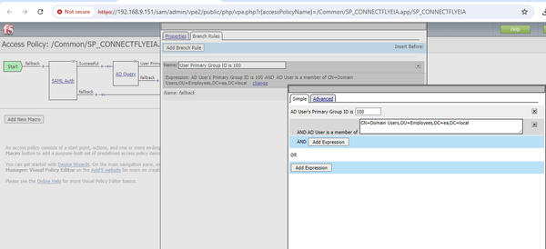

      What do the AD Query Branch Rules look like? Did you update the branch rule to be "AD Query User is a Member of x" ?
      If the branch rules are already correct, then you'll need to send the APM logs in a way that they aren't cut off on the right side. I can't tell what most of them say in your last screenshot.

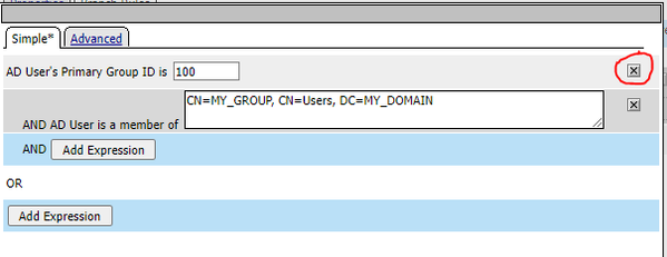

    • DanSkow's avatar
      DanSkow
      Icon for Cirrus rankCirrus
      That branch rule shows AD User's Primary Group ID is 100 AND AD User is a member of <group>.
