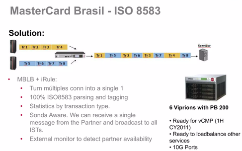

ISO 8583 pos transaction and one connect (multiplext to backend server)
Hello i have many pos and what connect to F5 for manage and loadbalance - all connection send to F5 and want to one session ( one connect ) multiplex like this pic

can help me ?
plz

  • I see something similar asked here and that is probably where the iRule comes from right?
    ISO 8583 Load Balancing | DevCentral
    There someone is also saying it doesnt work for them, that is the same for you? Do you get errors or anything that can help working to a solution?
    It seems a not very broad used protocol, you can for sure contact F5 support and see if they can assist. Next to that reach out to your account team, perhaps they can reach out internally to a finance vertical SE with experience on this.

      Thanks a lot for answer
      i checked it multi time
      but problem is that i need multiplex tcp session to backend server means else one session to server
      can help
