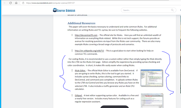

HI Guys. I read on an article that there is an Irules editor here in DevCentral, to check rules syntax before
testing. I'm totally new so this would be very useful i think. Is that true ? where can i find it ?
Generally speaking is possible to upload Irules code and have some expert opinion ? If Yes how ?

  • MarioMoneta I'm not sure of the application here but I use "Visual Studio Code" with the "F5 Network iRules" Extension installed. I believe the following is the link you need to get it all sorted with "Visual Studio Code" in Windows.
    iRules Editor & Declarative Development with Visual Studio Code | DevCentral
    As far as assistance with iRules people would normally create a new post explaining their issue or what they're trying to achieve and then the iRule in question. Most people are pretty helpful here when provided enough information to figure out a solution. The following search will probably show you a significant amount of previous posts where someone has asked for assistance with iRules and the ultimate solution to the query.
    Search | DevCentral
    I can't say for certain that an iRule assistance post will end up with a solution but most of the time a solution to the iRule or the problem itself is provided.
