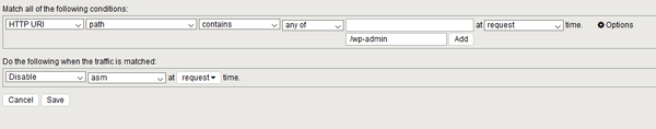

  • Thank You Sanjay, there is a way to to the same thing applying an rule in local traffic policy ? Like "HTTP URI path contains any of /wp-admin at request then disable asm at request time ? like the image belllow :
    • spalande's avatar
      spalande
      Icon for Nacreous rankNacreous
      Yes, you can use LTM policy or iRule to completely bypass ASM.
