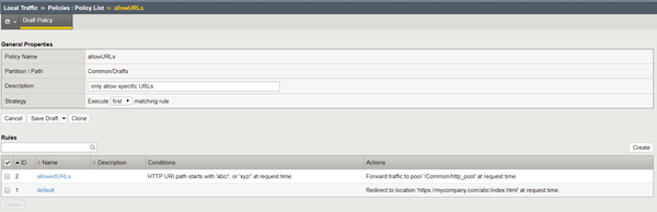

      Thanks fot your response. I tried this but it blocked the whole site. Also which version of bigip are you running on? I have 13.1.7 & i don't see same screen after policy creation.
      • Simon_Blakely's avatar
        Simon_Blakely
        That policy is missing a leading "/" for the URI paths, because I switched from "contains" to "starts_with" - sorry. Also, make it a case-insensitive check (using the options button)
        HTTP URI path starts with "/abc/", or "/xyz/" at request time
        It's worth persisting with Local Traffic Policies until you get them working - they really are the best solution to start with.
