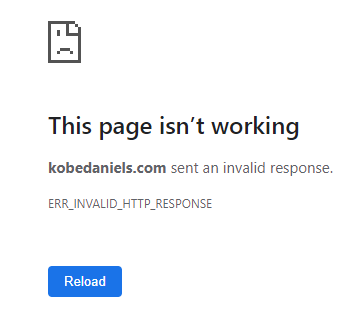

      My problem is not that I can't use HTTP/3 on the server side, i know that that won't work. But the problem is that when using HTTP/3 client side the server side isn't using HTTP/2. I know that HTTP/2 on the server side works because when using HTTP/2 on the client side I have HTTP/2 on the server side working with the same HTTP/2 profile.
      When forcing HTTP/2 always on by switching activation mode from ALPN to always I get this error in my Chrome browser:
      And this error on Firefox:
