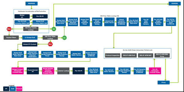

The diagram below shows the packet processing path on a BIG-IP. Notice it also shows reference to Advance Firewall Manager (AFM) packet path.
https://techdocs.f5.com/content/dam/f5/kb/global/solutions/K31591013_images.html/2018-0613%20AFM%20Packet%20Flow.jpg
Mitigation: LTM Packet Filter
On the left side of the BIG-IP packet processing path diagram, we can see the Ingress section and if the packet information is not in the Hardware Acceleration ePVA (Packet Velocity Asic) of the BIG-IP, it will be checked against the packet filter.
Thus, after determining that an IP address or a Network is suspicious and/or malicious based on gathered data from either the LTM Policy/iRules or AVR or external monitoring tools, a packet filter can be created to block these suspected malicious traffic sources.

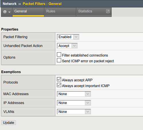

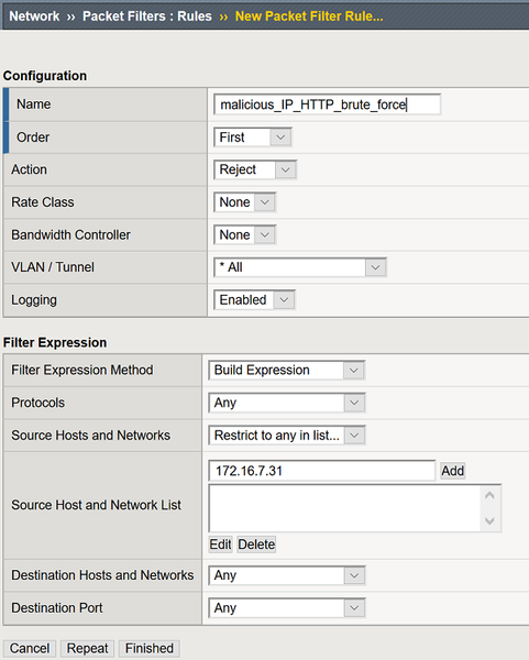

Packet Filter(ing) can be enabled in the Configuration Utility, Network ›› Packet Filters : General

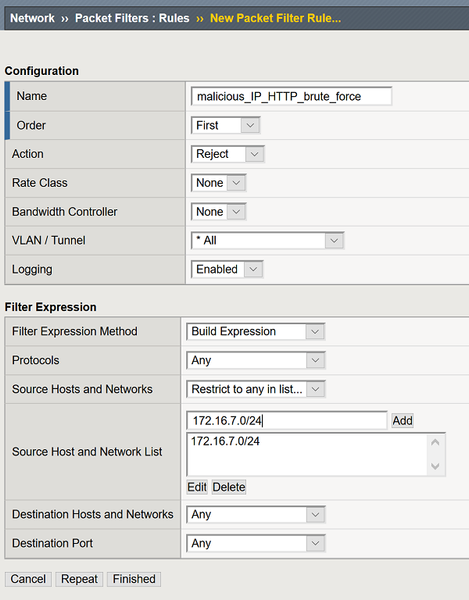

Packet filter rules can be configured at Network ›› Packet Filters : Rules
Sample Packet Filter Configuration:

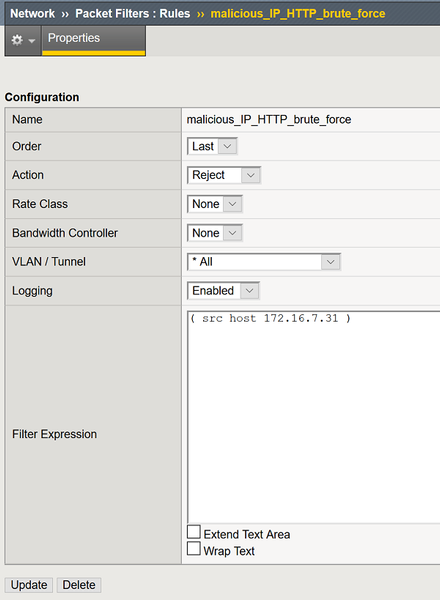

Packet filter configuration to block a specific IP address with the reject action and have logging enabled
Packet filter configuration to block a Network with the reject action

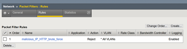

An Existing Packet filter rule
Packet Filter generated logs can be reviewed at System ›› Logs : Packet Filter
This log shows an IP address was rejected by a packet filter rule

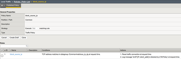

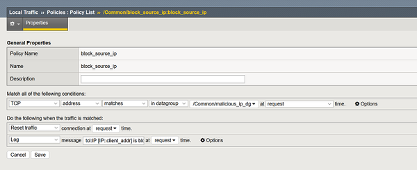

LTM Policy can be configured to block a specified IP address or from a iRule Datagroup.
Sample LTM Policy:
LTM policy tmsh output:
Tip: TMOS shell (tmsh) command 'tmsh load sys config from-terminal merge' can be used to quickly load the configuration.
Sample:
root@(sec8)(cfg-sync Standalone)(Active)(/Common)(tmos)# load sys config from-terminal merge
Enter configuration. Press CTRL-D to submit or CTRL-C to cancel.
LTM policy will block specified IP address:

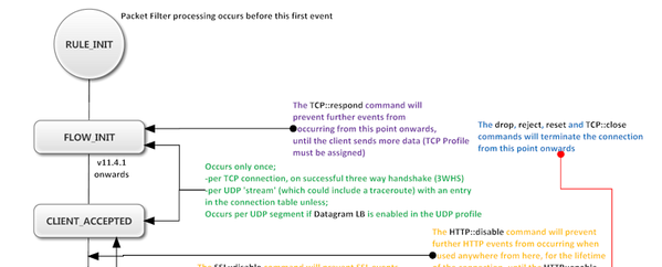

The sample iRule will block the matched IP address during the FLOW_INIT event.
FLOW_INIT definition:
This event is triggered (once for TCP and unique UDP/IP flows) after packet filters, but before any AFM and TMM work occurs.
https://clouddocs.f5.com/api/irules/FLOW_INIT.html
Diagram Snippet from 2.1.9. iRules HTTPS Events. FLOW_INIT event happens after packet filter events. If an IP address is identified as malicious, blocking it earlier before further processing would save CPU resource as iRules processing are resource intensive.

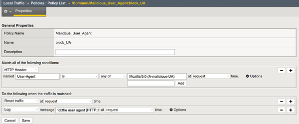

During HTTP Brute Force attacks, HTTP header User-Agent value is often what an incident analyst will review and prevent traffic based on its value, where, a certain user-agent value will be used by automated bots that launches the attack.
Sample Rule and LTM Policy to block a specific User-Agent
root@(asm6)(cfg-sync Standalone)(Active)(/Common)(tmos)# list ltm policy Malicious_User_Agent
ltm policy Malicious_User_Agent {
last-modified 2019-12-04:17:30:38
requires { http }
rules {
block_UA {
actions {
0 {
shutdown
connection
1 {
log
write
facility local0
message "tcl:the user agent [HTTP::header User-Agent] from [IP::client_addr] is blocked"
priority info
conditions {
0 {
http-header
name User-Agent
values { "Mozilla/5.0 (A-malicious-UA)" }
status published
strategy first-match
logs generated by LTM Policy in /var/log/ltm
Jan 16 13:11:06 sec8 info tmm3[11305]: [/Common/Malicious_User_Agent/block_UA]: the user agent Mozilla/5.0 (A-malicious-UA) from 172.16.10.31 is blocked
Jan 16 13:11:06 sec8 info tmm5[11305]: [/Common/Malicious_User_Agent/block_UA]: the user agent Mozilla/5.0 (A-malicious-UA) from 172.16.10.31 is blocked
Jan 16 13:11:06 sec8 info tmm7[11305]: [/Common/Malicious_User_Agent/block_UA]: the user agent Mozilla/5.0 (A-malicious-UA) from 172.16.10.31 is blocked
