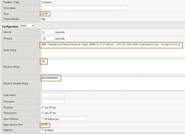

Custom Health monitor is always best option to check send/receive string. Ask application team to create one webpage and monitor that page via F5 HTTP health monitor. Its call ECV (Extended Content Verification) - some info is sent to the server and some info is expected to receive.
https://support.f5.com/csp/article/K2167
Below Screen will help you to understand the setting.
