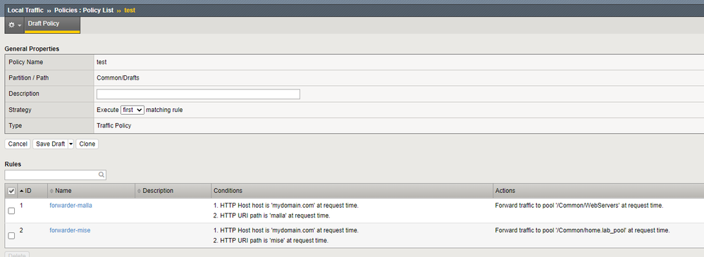

  • Hi,
    Does this have to be done by a irule.
    it can be done very quickly and easily using a local traffic policy.
    I can send you some config, if it can be a LTP not a iRule. (I'm not on top of irules yet!)
    • PSFletchTheTek's avatar
      PSFletchTheTek
      Icon for Cumulonimbus rankCumulonimbus
       Here you go, something like this. (Wanted to try the new devcentral out with photos! Very easy now!)
