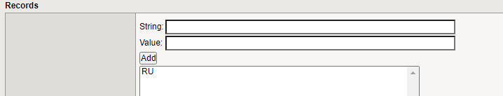

The iRule is slightly wrong in that it is trying to pull out a value of RU and then matching the IP address to the value which would never happen. I would use the framework set in the support article and do something like this:
when SERVER_CONNECTED { set ipaddr [IP::remote_addr] set fromCountry [whereis $ipaddr country] if { [class match $fromCountry equals GeoIPOutboundBlockRussia] } { log local0. "Attacker IP [IP::client_addr]" ;# This can be removed/commented out if not required drop } }
You are running into a formatting issue with your datagroup. The datagroup String should be RU and no value necessary. This is a good reference: https://support.f5.com/csp/article/K43383890.

Interesting. So I should just put RU in the string field and nothing in the value field, and that will be my string record, like this:
How about the iRule, does that part look alright?Thank you for your reply and help!
