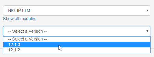

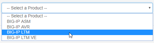

Only show the modules you actually have activated:
Only show the installed versions
You can still see all of them if you need to
