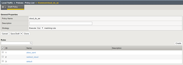

  • Use a Local Traffic Policy with a First Match strategy.
    K15085:  Overview of the Local Traffic Policies feature (11.4.0 - 12.0.0)

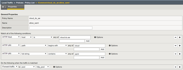

    Create a rule with conditions
    hostname is cloud.du.ae
    HTTP URI begins with cloud
    HTTP URI contains saml
    that forwards traffic to the pool

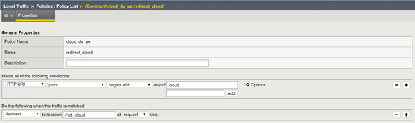

    Create a second rule to redirect requests starting with cloud to somewhere else (or drop the request)

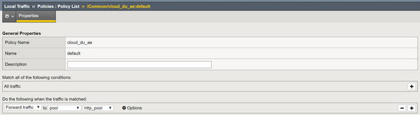

    Finally add a final default rule that forwards all requests to the pool.
    Order your rules so that they match in correct order:

      Works perfectly. Thanks a lot Simon :)
