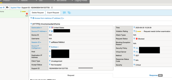

      • Hello, the category that seems to be blocking the valid traffic is "Botnets", you would still recommend removing that category? or would I make adjustments on the policy learning section?
      • Hello Crowe,
        Image is not available...
        If these are different IP addresses, but from the same subnet, then you can just add this subnet into Application Security : IP Addresses : IP Address Exceptions and Ignore IP Intelligence for it.
        If these are totally different IP addresses, but all of them are valid - it sounds strange for me, but in this case you can disable the whole category, to not add them one by one as exception via learning.
        If both case aren't good for you, then yes - proceed through the learning.
        Thanks, Ivan
