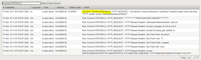

I tried HTTP::header remove "{esbsoapheader}userName" but it did not work. I got an error as follows
TCL error: /Common/ilxpi_demo/ilxir_demo <HTTP_REQUEST> - list element in braces followed by "userName" instead of space while executing "HTTP::header remove "{esbsoapheader}userName""

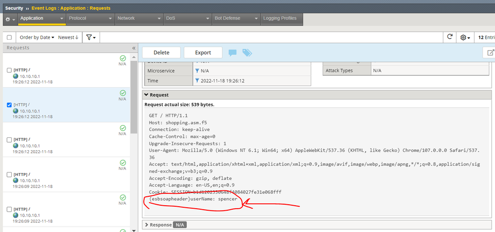

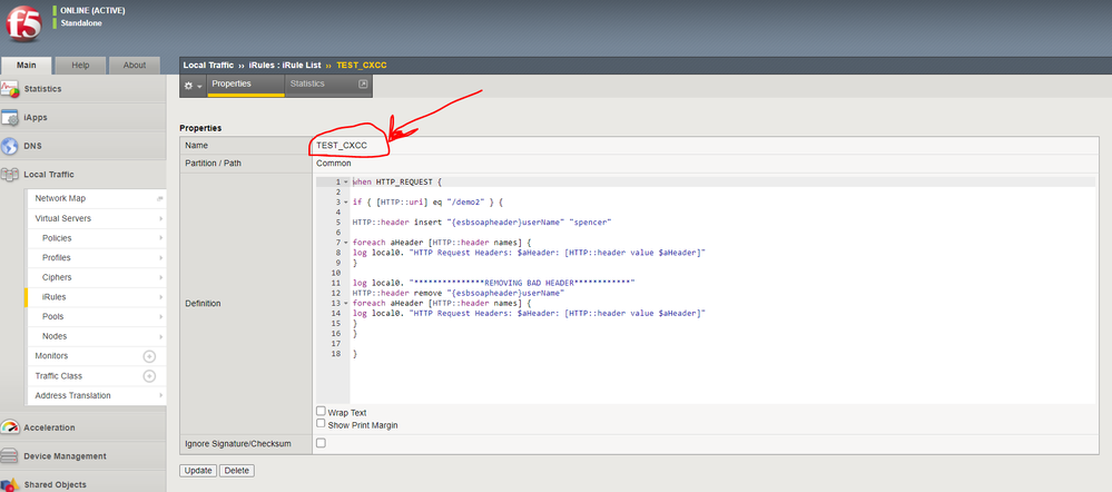

Thanks for your reply. Here is the example. I'm using this to test. In the real scenario, the header name "{esbsoaheader}userName" was already found in the HTTP headers, but in this test scenario and I'm adding it and then trying to remove it. I'm not sure how it worked for you.
when HTTP_REQUEST {
if { [HTTP::uri] eq "/demo2" } {
HTTP::header insert "{esbsoapheader}userName" "spencer"
foreach aHeader [HTTP::header names] {
log local0. "HTTP Request Headers: $aHeader: [HTTP::header value $aHeader]"
log local0. "***************REMOVING BAD HEADER************"

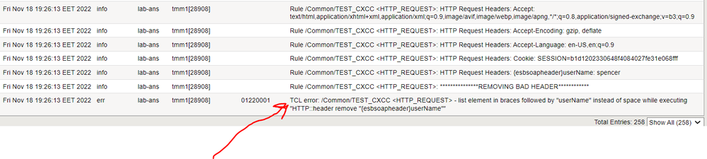

}LOGS
