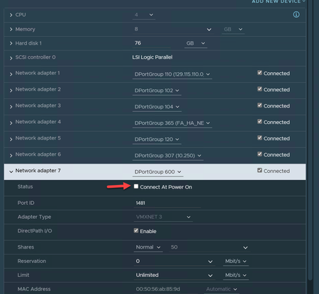

HA pair in VMware v7 update 3 - Should "power on connect" be enabled, or disabled for vlans/network?
- Feb 28, 2023
Hi, Fallout1984
I would begin by making sure that on both machines of the cluster all the network interfaces that *should* be up are indeed up.
If that's the case, you have part of your answer: interfaces that are currently down may safely be configured on VMware with "Connect At Power On" disabled.
If you notice some interface that should be up, but is not, it would follow the opposite logic: "Connect At Power On" should be enabled for those.
You can determine the relation between the VM network interface and the F5 interface by checking the MAC address on F5 with "ifconfig", and comparing to the MAC you see on VMware.
/Mike

- Fallout1984Mar 01, 2023
Cirrocumulus
Thanks! Here's what I got back from F5 Support, to add to this...
Should both HA pairs have their network adapter be checked for “Connect at power On” so they can connect at power on?
- According to our VMware ESXi: F5 BIG-IP Virtual Edition Setup, all needed network adapters should be configured for “Connect at power On”, as showed in the images included in the setup Guide.
You can consult the entire setup guide here: https://clouddocs.f5.com/cloud/public/v1/vmware/vmware_setup.html
