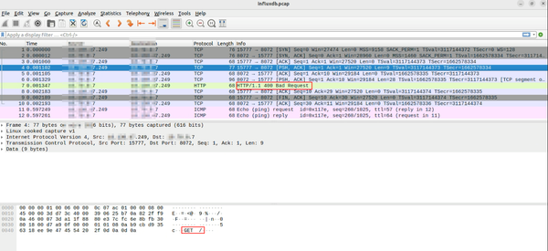

I've taken a PCAP on the backend server and, in analyzing the PCAP, it appears that the request F5 initiates to my backend server is a malformed HTTP request (see the GET / below which doesn't appear to be encapsulated in an HTTP segment). The backend returns a "400" and the client receives ERR_EMPTY_RESPONSE.

First, I would use auto map and instead I would setup a SNAT pool with the virtual server IP in question and use that as the SNAT pool in order to avoid possible issues with high connections. Second, what happens when you follow the tcp stream on that 400 bad request? Are you sure the client isn't making the request? You might be able to follow the ephemeral port for the request to the pool member because typically the
F5 attempts to use the same ephemeral port that the client uses when SNAT has been enabled.
