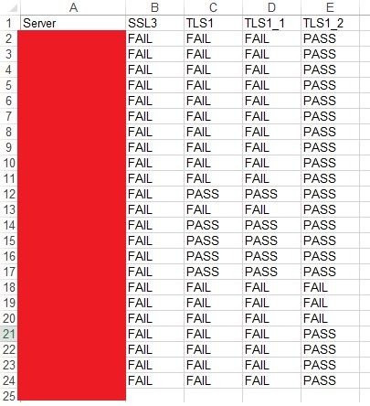

  • Here's something that I came up with yesterday, I used csv format to separate using comma and the output file looks fast & good too.

    Drawback:
    I could see the openssl command executing in the console. Have to pass this to a variable to run on the background. A bit of tweak should do the work.
    Output File:
    Edit: The script has been updated, refer the comments to find the latest.
