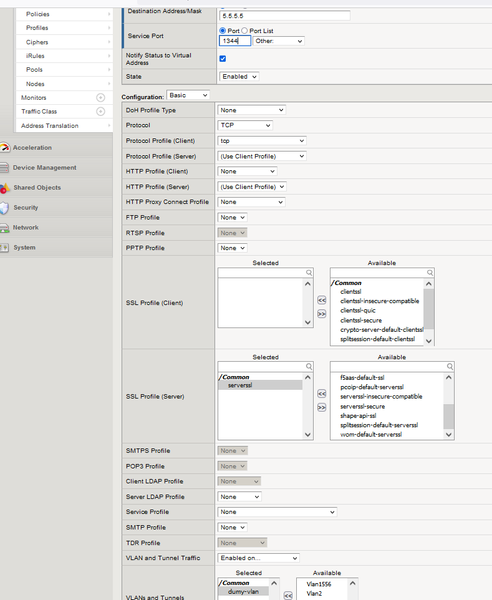

A Virtual Server can be created that has a server-side SSL profile and on the client side it is listening for unencrypted ICAP traffic. The Virtual server can have any kind of an IP address as it can be configured to listen on a Vlan that only exists on F5 system and it is not attached to any interface or trunk as the purpose is the F5 AWAF module internally to forward the Antivirus ICAP traffic to the Virtual server that will encrypt it and send it to the pool of the real ICAP servers.
As there is no official statement from F5 about this option, better test if it works correctly on your TMOS version, see the Virtual Server statistics and do tcpdumps to see the traffic being send to the F5 pool members!
Don't forget to add self-ip on the "dummy" vlan that is in the same range of the virtual server ip address, for example 5.5.5.6. If you have F5 devices in HA, you may need to add 2 non-floating and 1 floating ip addresses!

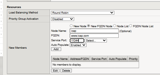

This will also allow to use multiple icap servers in a pool not just one and maybe some iRules to modify the traffic but for a better iRule support the LTM ADAPT Profiles option seems the way to go. If the icap server was resolved by FQDN then just add FQDN pool member as then the ICAP server ip address can dynamicly change or multiple icap servers can be discovered by single FQDN.

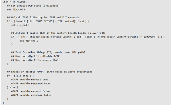

- F5 Adapt profiles support some iRule events and iRule commands like "ADAPT_REQUEST_HEADERS" that allow you to return different response pages, based on the HTTP headers that the ICAP server sends to the F5 device. For more information see https://clouddocs.f5.com/api/irules/ADAPT.html and https://community.f5.com/t5/technical-forum/is-it-possible-to-insert-http-payload-in-an-icap-reply-or-to/td-p/299959
If you decide to use the LTM Adapt profiles, because of the AWAF antivirus protection limitations that I mentioned, also configure some iRules or Local traffic policies that will limit the traffic being send to the ICAP servers for scanning like only POST requests for the URL where customers upload files, etc. You can see the examples at (the example is for SSL Orchestrator but in the background SSLO uses Adapt profiles for it's ICAP service):
https://clouddocs.f5.com/sslo-deployment-guide/sslo-08/chapter4/page4.5.html
