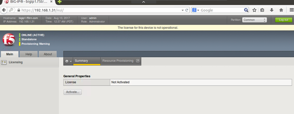

Now Im lost and I can only see that the license for this device is not operational

Update:
I tried to do the setup again. And import the Module3 lab UCS but going to the network map I don't see the pools. And license is not activated....
