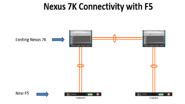

We have One Arm configuration, means only one Vlan for Client and Servers, Customer wants to make ether port channel between N7k and F5 ADC to bypass Spanning Tree, What Should be Port configuration on N7K access/ Trunk port ? What should be the Port configuration on F5 access or Trunk ?

conf t inter po85 switchport switchport mode access switchport access vlan 500 vpc 85
inter eth1/5 switchport switchport mode access switchport access vlan 500 spanning-tree guard root channel-group 85 mode active
interface port-channel85 description F5 switchport mode trunk switchport trunk allowed vlan 500,510 vpc 85
interface Ethernet6/35 description L2 Interface for Viprion 1 Eth1/1.4 switchport mode trunk switchport trunk allowed vlan 500,510 spanning-tree port type edge trunk spanning-tree guard root channel-group 51 mode active no shutdown

So i assume u are using HSRP with a primay and secondary since you aren't taking advantage of VPC . I would suggest you connect each F5 to both 7ks. You don't have to run VPC for this. Spanning-tree will kill one link. - Brandon_12607
If you want to do the design that you are doing. just don't add the VPC to the port-channel interface. - MM_F_147944
what should be the port on Nexus it should be access or Trunk as one Vlan is running
