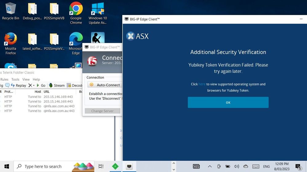

thanks for this - my authentication provider is forgerock and oAuth with openid is working -
the problem is the Edge client - as you showed in your video it should open the browser and authenticate and VPN should establish - and that happens - but it also opens its embidded browser where yubikey fails.
Question how do i configure it in a way where iy does not open the embidded browser?embedded

If the embedded browser opens, it means OIDC edge client config is wrong. It should open a real browser window.
Check your edge client config.

i have configured it as a client - with client ID and secret2 - and in visual policy editot - i have used oAuth client - instead of oAuth Scopeand all of this works fine when i use the browser - but the edge client has issueswhat do i need to dodo i need to configure 0Auth server entity as resource -and then use 0Auth Scope in visual policy editor?and my OAuth server is ForgerockThanks- awan_mMar 14, 2023

Hi i watched the video multiple times and tries to set it up as recommended in the video.
couple of questions
what should i put in the following in oAuth setting - for edge client
Complete Redirection URI: --
secondly - if i leave that blank - the edge client keeps going to login page - and login process
